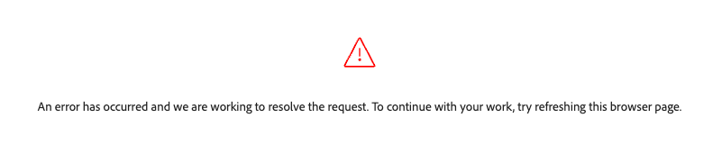

yeah.. i've tried a few ways and i still can't get it to work.
when i use it in the filter i receive this error
I have been successful in creating a column in the report with the data.  but can't seem to get this to work in the filter.
I have tried both
lastNote:owner:homeGroupID     and
lastNote:owner:homeGroup:name
I've tried notin and cine.
everytime i get the error.
any other ideas?
