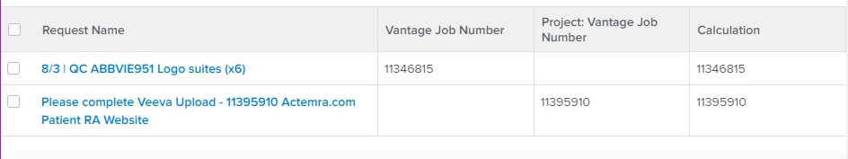

Best answer by imgrund
Interesting, I did a test in my enviroment with a field called Vantage Job Number and it worked fine. My calculation is
displayname=Calculation
textmode=true
valueexpression=IF(ISBLANK({DE:Vantage Job Number}),{project}.{DE:Vantage Job Number},{DE:Vantage Job Number})
valueformat=HTML
Check your valueformat field. It should be HTML or string. Not customDataAsAString

ShawnMeAuthor
August 6, 2020
Ah. The issue was using a period instead of a colon between {project} and {DE:Requester}. You actually used a colon the first time, which is what I thought it should be and had used in all of my attempts. Your second post corrected it. Thank you very much, again, Anthony.
