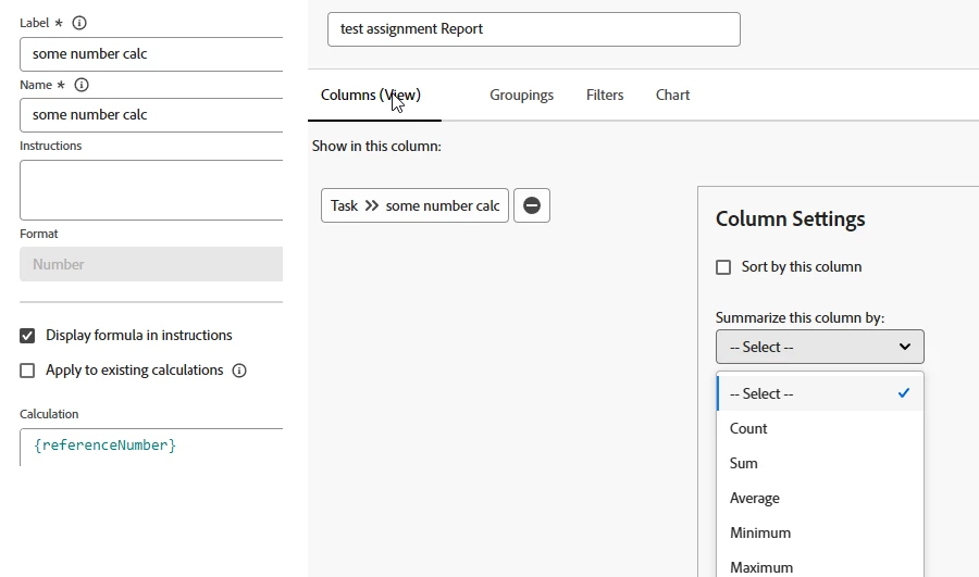

I tested a calc field on a task, that I wanted to pull in on an assignment report: The field is type number - and the report UI shows the expected "summarize" options...
Check that calculated field that it indeed produces a numeric value?
