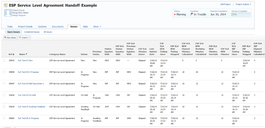

Hi Narayan. A couple of years ago a large Workfront client engaged us to build out a similar solution for tracking the response and resolution time on Issues. The resulting SLA (Service Level Agreement) Package has some very cool reports and dashboards on it such as this one , but The Math behind it is not for the faint of heart! That said, the end justified the means, and I'm certain it could be adapted to accomplish what you are after: tracking Status state-times at the Project level. Regards, Doug

Fun fact: Workfront does carry a Previous Status field under the hood (eg at the Issue level, etc)...but not the date that it changed, which is I think what you seek.
It is possible to track that information in custom date parameters, as I alluded to in The Math above, but it is very complex. That said, once those custom forms are in place, it becomes trivial to then Filter, Sort, and Group on them using Workfront's standard reporting (eg Report all Projects that have changed Status within the past Month, Grouped and Sorted by the Week in which the Status changed and then by Project Owner, and show the Portfolio Name, Project Name, Last Note, Previous Status, and Status in the grid). If you'd like more information, please drop me an email at doug.denhoed@atappstore.com.
