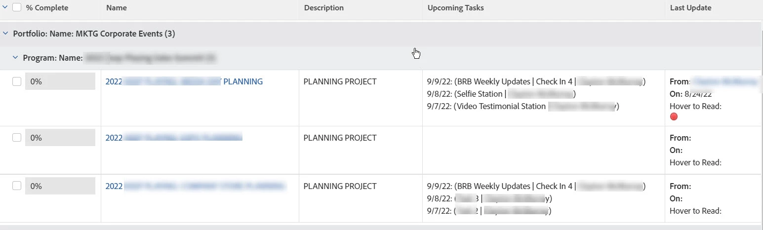

RhondaGayleTX
RhondaGayleTXAccepted solution
September 6, 2022
I have a column that displays task due date, name of task, assignee for tasks due in the next 7 days:
TASKS=A WEEK AHEAD
displayname=Upcoming Tasks
listdelimiter=<div>
listmethod=nested(tasks).lists
textmode=true
type=iterate
valueexpression=IF({numberOfChildren}=0,IF({plannedCompletionDate}>$$TODAY+1d && {plannedCompletionDate}<$$TODAY+1w,IF(ISBLANK({actualCompletionDate}),CONCAT({plannedCompletionDate},": (",{name}," | ", {assignedTo},")"))))
valueformat=HTML
width=300
I hope this helps!
