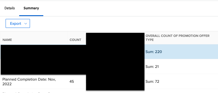

We had a similar experience where we wanted to count certain drop down options from 12 different fields with like drop down options to be able to sum them up on a summary report.
Maybe this can help you out with your scenario.
Here is an example on what we did with a calculated field that we set to a number output on the field.
SUM(IF(CONTAINS("Promotion",{DE:Offer #1 Type}),1,0),IF(CONTAINS("Promotion",{DE:Offer #2 Type}),1,0),IF(CONTAINS("Promotion",{DE:Offer #3 Type}),1,0),IF(CONTAINS("Promotion",{DE:Offer #4 Type}),1,0),IF(CONTAINS("Promotion",{DE:Offer #5 Type}),1,0),IF(CONTAINS("Promotion",{DE:Offer #6 Type}),1,0),IF(CONTAINS("Promotion",{DE:Offer #7 Type}),1,0),IF(CONTAINS("Promotion",{DE:Offer #8 Type}),1,0),IF(CONTAINS("Promotion",{DE:Offer #9 Type}),1,0),IF(CONTAINS("Promotion",{DE:Offer #10 Type}),1,0),IF(CONTAINS("Promotion",{DE:Offer #11 Type}),1,0),IF(CONTAINS("Promotion",{DE:Offer #12 Type}),1,0))
