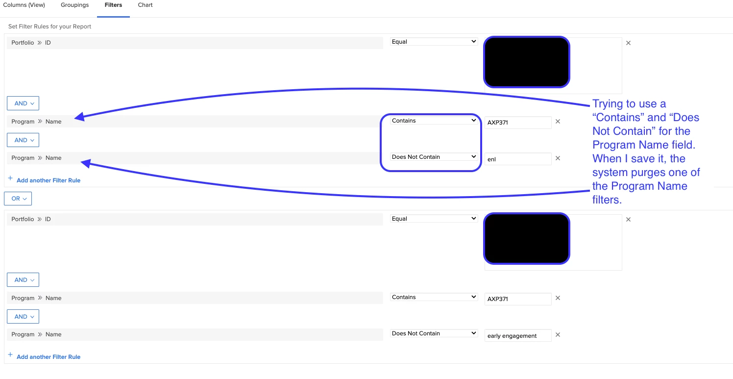

I'm trying to create multiple filters in a report, filtering on the same field (Program Name).
- I want results where the Program Name contains "AXP371"
**AND**
- I want results where the Program Name does not contain "enl"
When I do this, whether in the standard interface or using text mode, the system strips out one of the Program Name filters.  Does anyone know if it's possible to create a report with this filtering?

Hello Nick,
you are right, using the UI one of the filters seems to be ignored, but using text mode with AND:1: works, if I do not miss anything:
name=AXP371
name_Mod=cicontains
AND:1:name=enl
AND:1:name_Mod=notcontains

Nice, that worked, thanks Lars!
Can I add an OR in that text mode so the whole query solves for the following:
This is the first part you helped me solve for already...
**AND**
This is the second part I want to add as an OR (in addition to the above)...
**OR**
**AND**
- I want results where the Program Name does not contain "early engagement"
without having it tested in detail, this could work:
name=AXP371
name_Mod=cicontains
AND:1:name=enl
OR:2:name=AXP371
OR:2:name_Mod=cicontains
AND:2:name=early engagement
AND:2:name_Mod=notcontains
Regards
Lars
Thanks, Lars.  No luck so far with that 2nd one, but looking into it.
