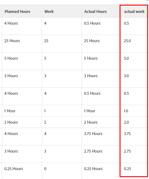

Try actualWork instead, that should give you what you're looking for.
displayname=
linkedname=direct
namekey=actualWork
querysort=actualWork
textmode=true
valuefield=actualWork
valueformat=integer
thanks Sheri, but that unfortunately didn't work, and it removed all values, so the column is now blank.
I'm looking for it to appear as 00.0 instead of 00.0 Hours
Any ideas?
What kind of report are you using? I tried this on a task report and it worked to return only the numerical values

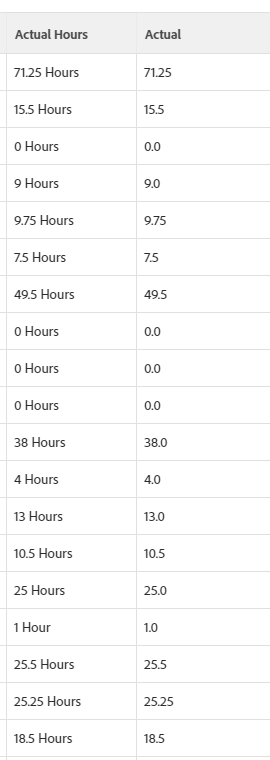

Hi Sheri,
Thanks for looking at this, it is a project report. Here is what I get when I try:
Got it. This was tricky and the credit goes to @kynabaker16, who solved it in this post Remove the string "Hours" when creating a report..
Here's what worked in my project report:
displayname=Actual
linkedname=direct
namekey=actualworkrequired
textmode=true
valueexpression=DIV({actualWorkRequired},60)
valuefield=actualWorkRequired
valueformat=compound
viewalias=actualworkrequired
this worked!! thanks so much, I appreciate your time.
