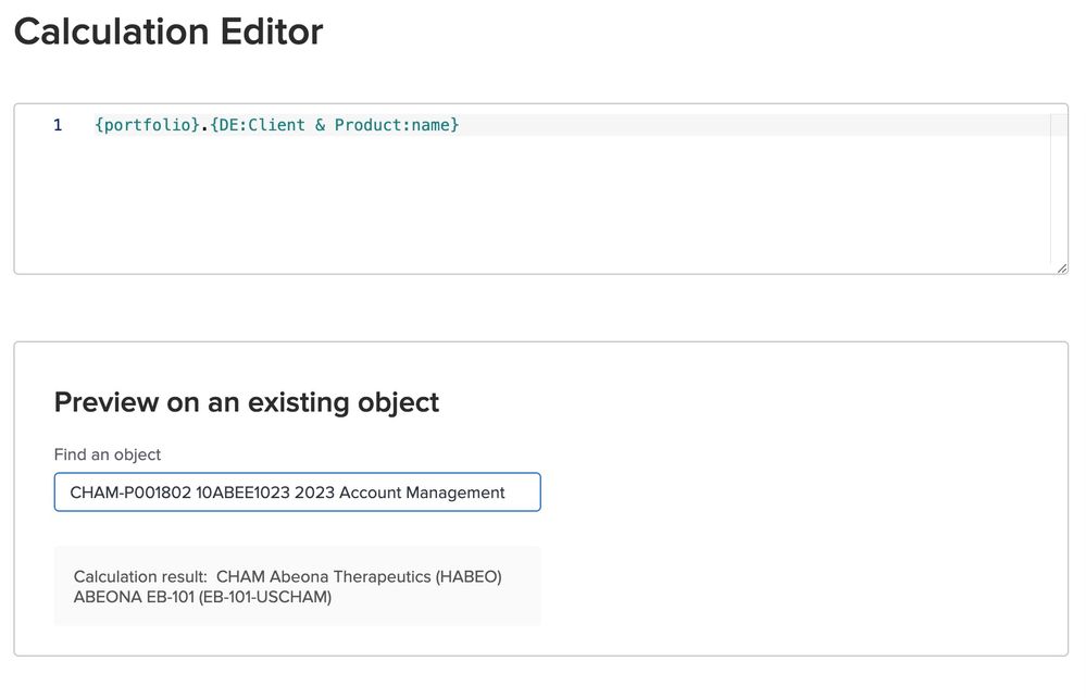

RandyRoberts
June 1, 2023
When I logged in today, it magically started working… with all the same custom fields I tried yesterday
Same field as yesterday
Typeahead Field
