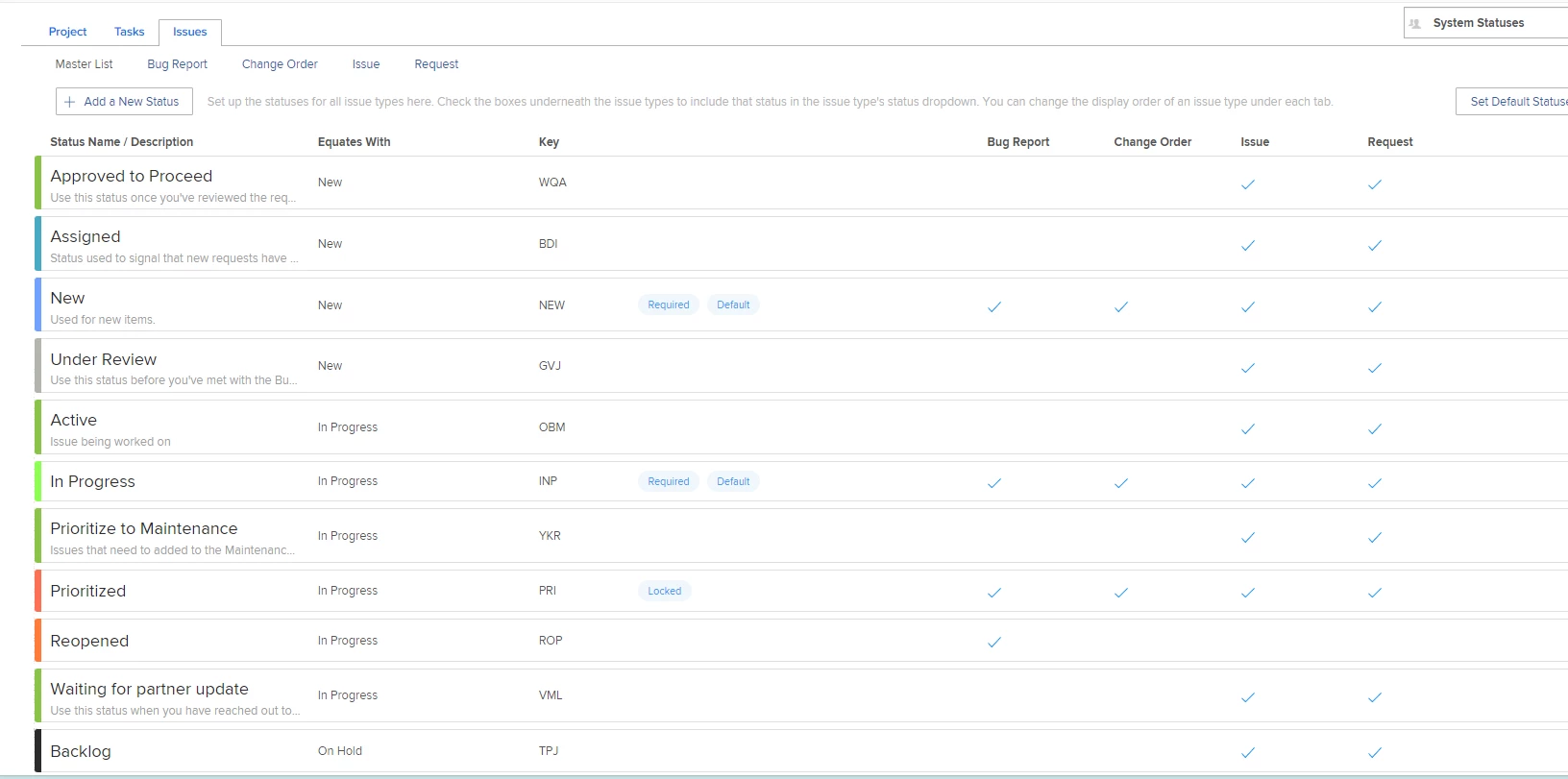

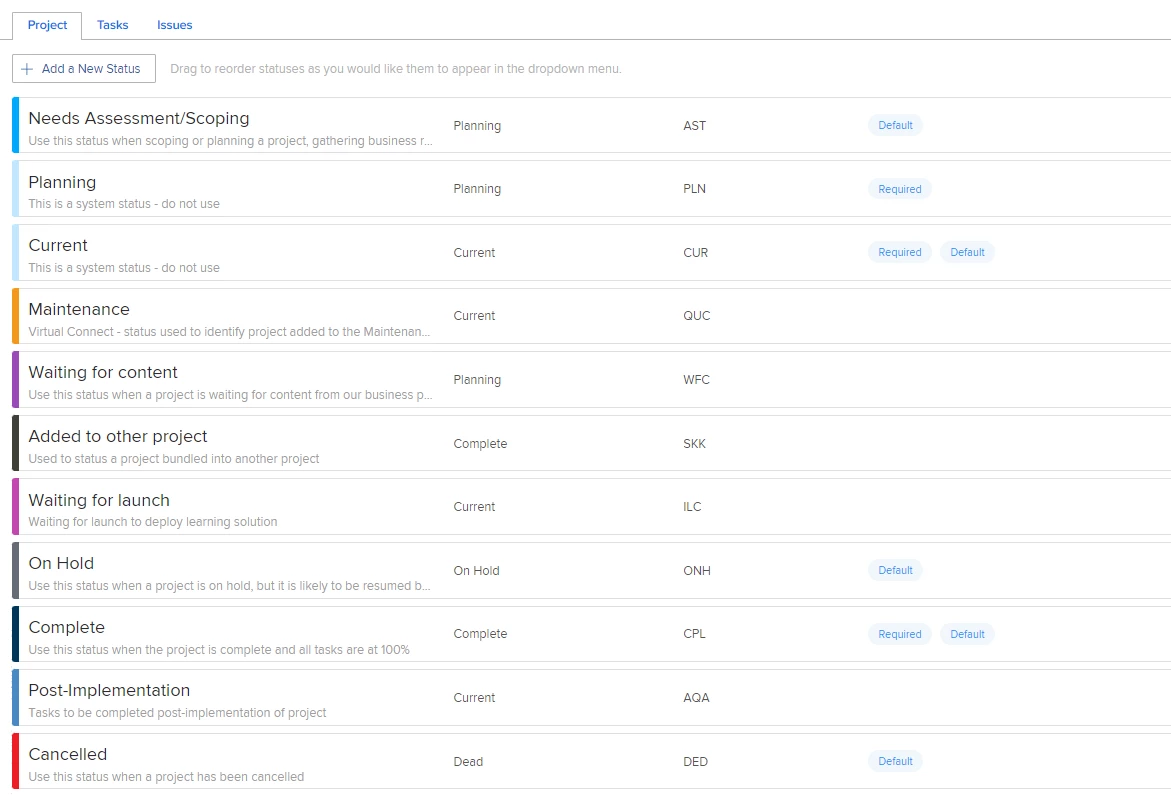

I am currently working through our oversized catalogue of statuses and I can't figure something out for the life of me. It's probably super obvious and I'm just missing it.
We have a number of Projects with the Status: Active.
When I go into Project Preferences - Statuses - Project = there is no status that exists called Active.
We convert our projects from Issues, so I checked Issues. There IS an Active, but it's not the same colour as the one that shows for Project Status....

Is the Status applied at the Group level? In the upper-right corner where it says "System Status" try entering the name of a Group that you know has access to that Status. Different Groups can have different Statuses.

I would suggest checking, which group those projects are associated to under Overview -> Project association.
If you open that group under Setup -> Groups, have a look under the Status tab there.
You can also jump to that group using the input field on the top right of your first screenshot.
