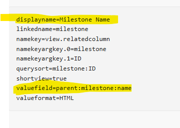

To add the Milestone into the task level report, I was told to use this code using the Milestone ID field and going into text mode.  One of the WF gurus showed me this...  It worked great!
