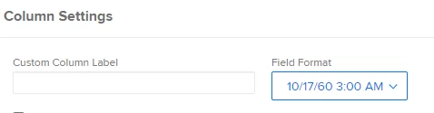

Hi there! Date fields in a report can show just date, or date + time. Go into the date column of your report > advanced options > there are field formats you can choose from. Is this what you're looking for?
flieckster
March 15, 2023
@madalyn_destafney Hi! ideally yes that would work, but this is a project report with task level data, so to get the task level data i need to use text mode to pull in the information. i assume that "{plannedCompletionDate}" has date/time in it, but i don't know how to display it as date and time, just date at the moment.
Heather_Kulbacki
March 16, 2023
@flieckster  try replacing the valueformat in your text mode with this.
valueformat=longAtDate
To find this, I took a project report, added the date format that Madalyn mentioned to a date field, then flipped that to text mode too see the valueformat
