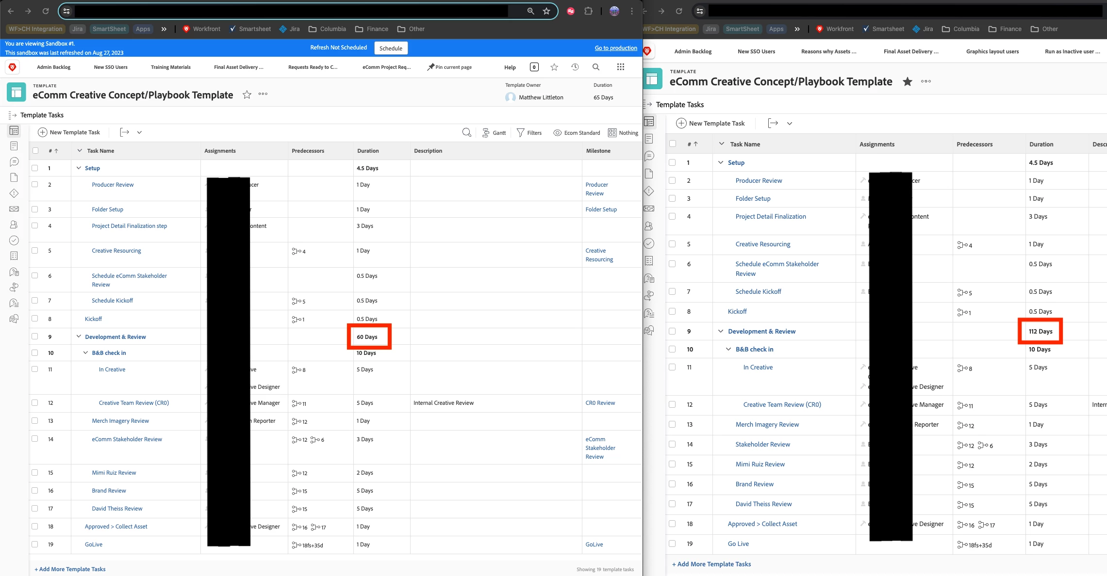

I'm attempting to rebuild templates that I created within my sandbox environment but when I build them in prod the total project duration is completely off. I've included a screenshot below of the template I'm trying to recreate
As you can see the development & review summary task says the steps will take 60 days in the sandbox but the same template with all the same tasks, durations, task constraints, and predecessors is saying it will take 112 days in production

Can you post a screenshot of a view that includes the task constraint, start day, and completion day as well, please.

Hi @skyehansen, here's a screenshot with those columns!
Looks like the issue may be with tasks 13 &14 as they are set to as late as possible but not connected by predecessors to the go live which needs to finish at a set time. Regardless though, I'm still confused by why the dates are so different for both.

It's difficult to comment accurately on how anything might have happened, since I was not there to witness the actions that led to this point. I think you mentioned that you were talking to Support about this so this is definitely a conversation you can take up with them. Suffice it to say that the reason that Workfront suggests that you make edits to your template by editing a project instead, and then reconvert it back into a template is to avoid issues like this. (They're much easier to spot in project form)
For the purpose of fixing your template, I would probably suggest that you try and see if you can change the start and complete day columns through inline editing.
