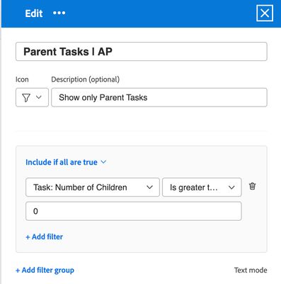

or you could create a "Parent Tasks Only" filter and share it with others, like this:
Thank you so much!  That was easy and looks really nice when PDF'd.  I appreciate it!
