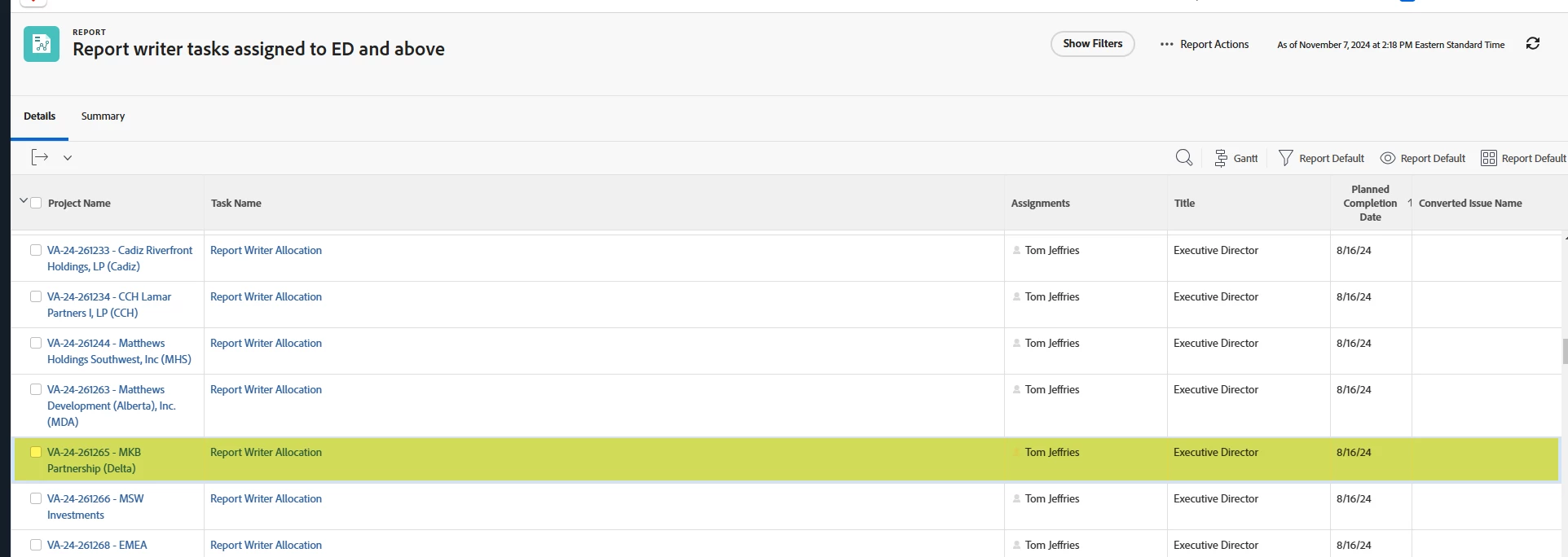

I have a process where we are trying to see if an issue / request has been submitted that gets moved to tasks. I need the report to stay as a task report due to certain necessary filter criteria that I can't apply to an issue report.

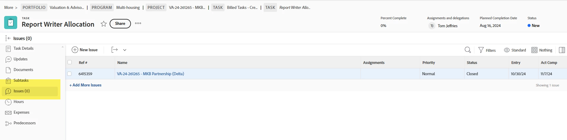

I need to reference if a task has an issue sitting on it - we don't convert the issues, we are just moving them.
Is this possible to do in text mode?
Here are some screenshots. Basically, I want the converted issue name, but it's not converted just moved.

I recommend you look into using collections in a report:
https://experienceleague.adobe.com/en/docs/workfront/using/reporting/reports/text-mode/reference-collections-report#reference-a-collection-in-the-view-of-a-report
You can literally steal this textmode straight off their page, as it should work for either task or project reports.
displayname=Issue Names
listdelimiter=<p>
listmethod=nested(issues).lists
textmode=true
type=iterate
valuefield=name
valueformat=HTML

May be you can still create a Issue report with 'Parent:name' as the group by and apply filters on the Parent and parent type.
