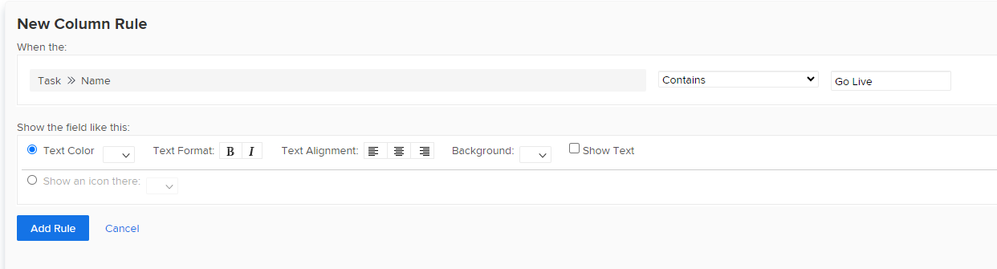

Task Level Report
Note: I copied the text mode for this, but you can really just go Advanced Options > Add a Rule on this Column on a Planned Complete Date column and change the back-end to Task > Name contains Go LiveScreenshot 2023-07-17 153928.png
valuefield=plannedCompletionDate
querysort=plannedCompletionDate
valueformat=atDate
displayname=Final Deliverable Due Date
linkedname=direct
namekey=plannedCompletionDate
styledef.case.0.comparison.leftmethod=name
styledef.case.0.comparison.lefttext=name
styledef.case.0.comparison.righttext=Go Live
styledef.case.0.comparison.operator=cicontains
styledef.case.0.comparison.operatortype=string
styledef.case.0.comparison.icon=false
styledef.case.0.comparison.truetext=
