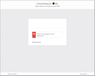

Although the user has been correctly assigned a Workfront license in our admin console, they are encountering the following error when attempting to log in:
"User is not assigned to this application."

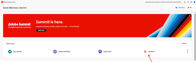

  1. Go to: https://experience.adobe.com/
  2. Enter the email and password they already use within their organization

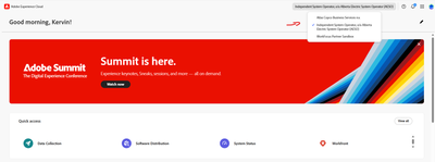

  3. If they are registered under multiple companies, once they land on the Adobe Experience Cloud homepage, they will have the option to switch between different company instances
4 - They need to select the correct organization and then click on the Workfront icon.

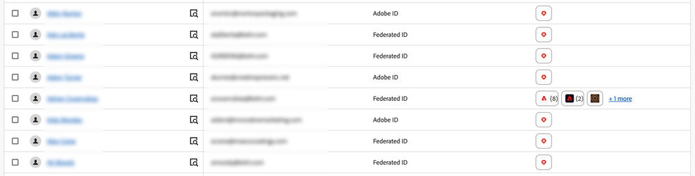

Recommendations: Always check the Admin Console to verify whether the external user you created in Workfront is using an Adobe ID or a Federated ID.

We have some external vendors who have access to Workfront.  In Adobe Admin Console we have internal users set up with a Federated ID, all external users should be using an Adobe ID.
