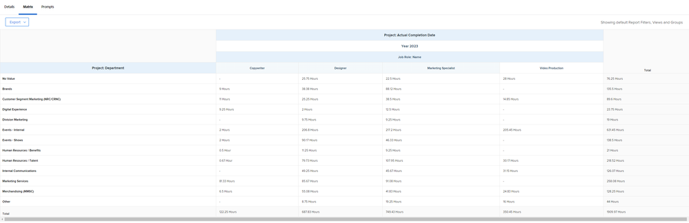

November 14, 2023
Agree with Kellie, and an assignment report with matrix grouping is what we landed on. This example is grouped by project department, but you could group it by project name.
