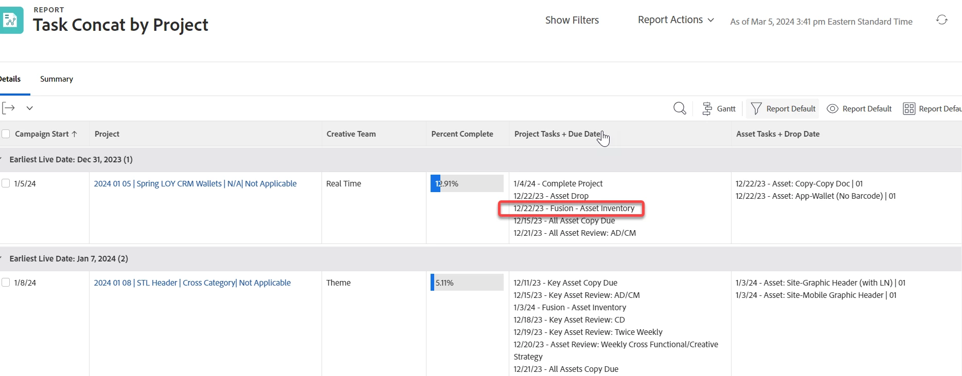

Hi! I'd like to filter out a specific parent task from showing in a report. However, a filter is not working now that I've combined all tasks into one field. Anyone know how I might manipulate the valueexpression for the Project Tasks + Due Date column to also NOT CONTAIN "Fusion - Asset Inventory" parent task? Thanks in advance! New to using text mode!
displayname=Project Tasks + Due Date
listdelimiter=<p>
listmethod=nested(tasks).lists
textmode=true
type=iterate
valueexpression=IF(CONTAINS('Asset:',{name})=true," ",CONCAT({plannedCompletionDate}," - ",{name}))
valueformat=HTML
Best answer by KellieGardner
It looks like you would also need to remove the : as well since the parent task isn't formatted as "Asset:"
IF(CONTAINS('Asset',{name})," ",CONCAT({plannedCompletionDate}," - ",{name}))
I just looked at your task list you posted and see that it would filter out additional items in the milestones below so I would do 2 IF statements combined.
Try this:
IF(CONTAINS('Asset:',{name})," ",IF(CONTAINS('Fusion - Asset Inventory',{name}),"",CONCAT({plannedCompletionDate}," - ",{name})))

I need to keep the "Asset" statement in there b/c it's differentiating the two different task types we have - project column does NOT contain tasks with "Asset:" but the Asset Task column does. I want to also remove the "Fusion - Asset Inventory" parent task from what's showing in the project column, however. Does that make sense?
ColleenKlAuthor
March 5, 2024
Did you try using the code I gave and it's still not giving you the results you want?
Correct - when I removed the "true" from the formula, the "Fusion - Asset Inventory" task was still showing in the Project Task column.
