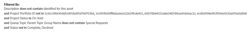

I'm trying to create a filter for an issue level report where the parent topic group does not contain a certain name.  Sadly, parent topic group name doesn't appear to be one of the canned/selectable filters to simply add, unless it's called something other than parent topic group name.  So, I'm resorting to text mode.  I found this post (https://experienceleaguecommunities.adobe.com/t5/workfront-questions/filtering-on-topic-groups/m-p/502440#M34190) where someone else was able to filter by ID.  But, the parent topic group ID is unique within each project, so ID isn't doable.
Has anyone run into this before?  I don't see why adding an extra filter like the below isn't working:
queueTopic:parentTopicGroup:name=Special Requests
queueTopic:parentTopicGroup:name_Mod=cinotcontains
The "Show Filters" button on the report reads exactly like what I'd want, but the report generates an error.

Thanks for the reply, didn't have any luck.  I get the queueTopic:parentTopicGroupID filter to work, but the ID is unique every time, so I thought queueTopic:parentTopicGroup:name may do the trick, which it doesn't.  I saw someone else suggest in the other post about using custom forms, which looks to work fine in some brief testing, that's probably the route I'll go here.
October 27, 2023
I'm not sure why you "didn't have any luck", since you didn't bother posting any error messages? If you followed along with the original link I posted, you should have gotten to something that looked like this sample code below.
EXISTS:A:$$OBJCODE=QUET EXISTS:A:ID=FIELD:queueTopicID EXISTS:A:parentTopicGroup:name=Special Requests EXISTS:A:parentTopicGroup:name_Mod=cicontains EXISTS:A:$$EXISTSMOD=NOTEXISTS
 First two lines: there exists a queue topic where the queue topic's ID is the queueTopicID of your issue. (as you mentioned above, this is the unique identifier)
Next two lines: ALMOST exactly what you had, but now you are allowed to "remove one of the levels" (this is from my original response -- you have too many levels, and an exists statement is how you get to remove one level)
Last line: instead of saying "cinotcontains" your filter says "cicontains" and the last line is how you say "not"
That did the trick this time, I must of been doing something wrong when I tried previously.  I have it working with a calculated field on a custom form, so now I can just have the field readily available for the future anyway.
