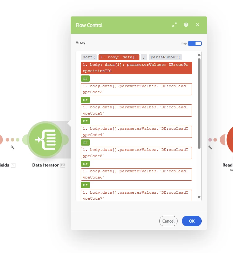

Hello, Hoping someone can assist.
I need to compile field-level data from multiple tasks and add it to a CSV file. The issue I’m facing is that the data is arriving in separate bundles, whereas I need it in a single bundle to correctly position the fields in the CSV, ensuring they appear in the right order and row.
Does anyone know of a way to merge separate bundles into a single, easily manageable data set?
Any suggestions would be very welcome!

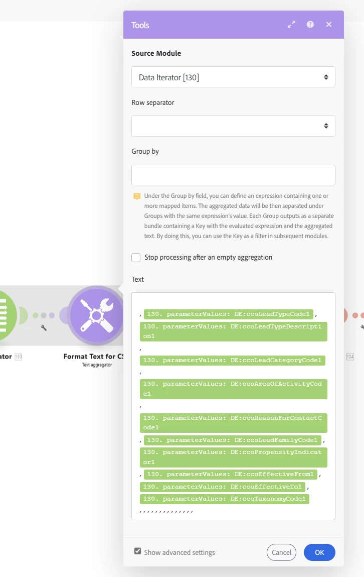

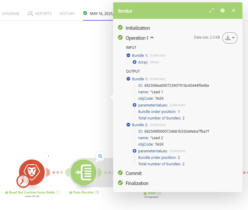

I have managed to solve my issue a different way, that works:
I iterated on an admin only field to ensure the custom form text comes through in the order I want to avoid the bundles going out of order.

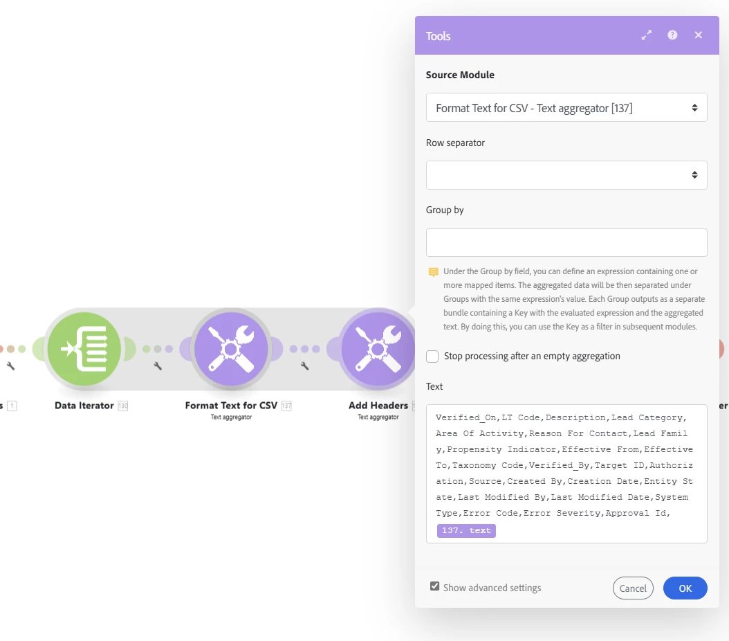

Then I format the text in the columns I need then Aggregate on that text again to add the column headers.
This has given me the result I needed for my CSV.
