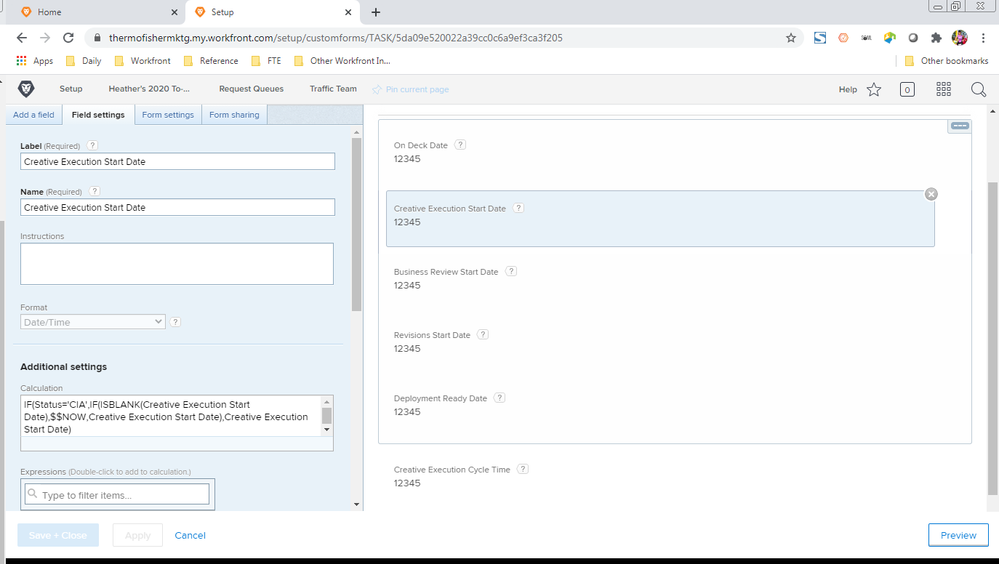

Hi Laura,
Here's a screenshot of our fields. A couple points to remember in creating these fields
  • you'll see the one I have highlighted references itself in the calculation. So you'll need to create a calcualted field, name it, but don't add a calculation yet. Save it, then add the calculation in. Until you've saved that field name, you can't reference it in a calculation.
  • since we put this form on a task which moves across a Kanban board, the task status changes automatically. If you're not using a Kanban board, the task status will need to be changed manually to capture each stage that you're looking to track.
Then the last field "Creative Cycle Time" is just a calculation between "Creative Execution Start Date" and "Business Review Start Date" and that "Creative Cycle Time" field can be pulled into a report.
Additionally, we originally came up with this workaround because a user would click "Work on It" on a task or issue, but would have to manually change the task/issue status to capture an actual start date. And we didn't want them to have to do that extra step.
I suspect we'll be retiring this form soon. Now that we have the ability to re-set the "Work on It" button to a "Start Task" or "Start Issue" button within each Team, we're reminding users to click "Start Task/Issue" when they actually start working on something to track the cycle time.
