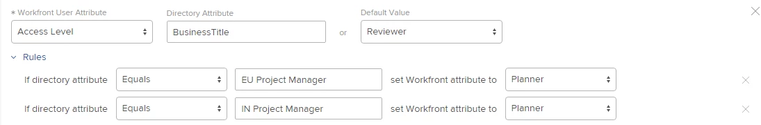

April 27, 2017
We have this setup on our instance, we have licenses configured by job title giving everyone a reviewer license unless job title matches those that will need a plan/work license.
