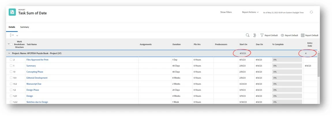

I want to get a column in a task report that puts the MAX date in when the task meets a criteria.  Ultimately I want a series of columns that grab the date off of a different task. I was trying a basic example but I never seem to get a date appearing in my aggregate…See simple example below
aggregator.displayformat=atDate
aggregator.function=MAX
aggregator.namekey=entryDate
aggregator.valueexpression=IF({wbs}=1,{entryDate})
aggregator.valueformat=atDate
displayname=
linkedname=direct
namekey=entryDate
querysort=entryDate
textmode=true
valueformat=atDate
I am sure you used to be able to do this but it does not like it now. The aggregator on the regular column gets the "Whoops something went wrong" message.

Thanks Doug, yes my other column highlighted showed exactly the same potential... but not there in the IF statement.
