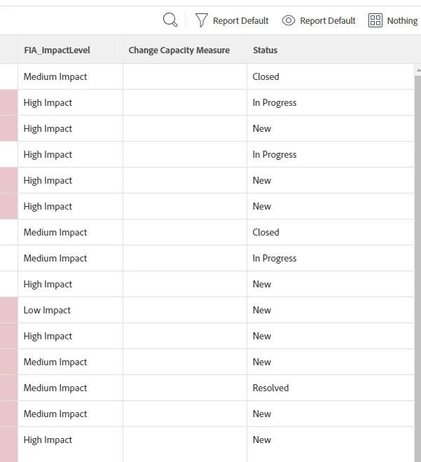

I am trying to add a rating column based on the impact level on an issue report. I have created an IF statement for the column in text mode to look at the level and assign a number, but it doesn't seem to work. I am not sure if my IF statement format is incorrect, or if there is a better way to do this? Any help is greatly appreciated.
If statement in Text Mode:
displayname=Change Capacity Measure
textmode=true
usewidth=true
valueexpression=IF({DE:FIA_ImpactLevel}="Low Impact","2",IF({DE:FIA_ImpactLevel}="Medium Impact","6",(IF({DE:FIA_ImpactLevel}="High Impact","9","")"")"")
valueformat=html
width=33

I have tried your recommendation to firs test the one IF statement : IF({DE:FIA_ImpactLevel}="Low Impact","2","") and it did not work. I'm not sure if I need to define a syntax before "Low Impact" since it is one of three options from DE:FIA_ImpactLevel field.
