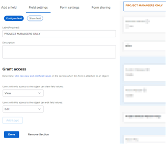

When you click the section of interest on the custom form, the "Grant Access" section should appear on the left side, as shown below (where you can then choose the audiences for View and Edit).
On the Gotcha side (although it was a while back, and might have been fixed)...my convention is to put such sections at the bottom of the custom form (ideally, the last section), since for forms with multiple sections an such permissions, I recall seeing such permissions "leak" into sections further down the form.
