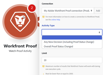

You have to use the Proof modules.

You could look at the document currentVersion object - here the fields that are tracked on versions
