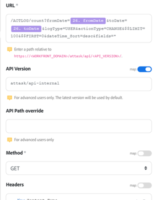

Best answer by SamyukthaPa1
Hello @sivak1 ,
You can use Internal API

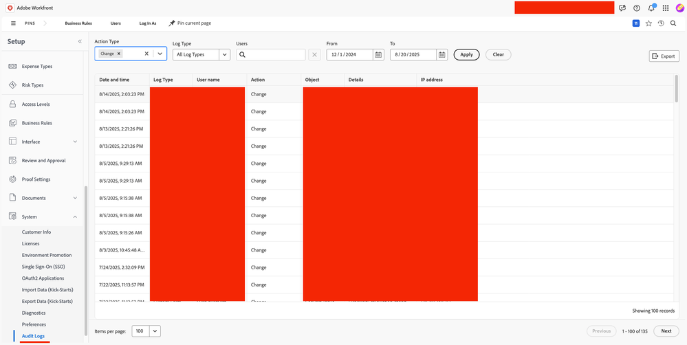

Hi @sivak1,
If you have admin access you can go to the Setup -> System -> Audit Logs this is out of the box feature and it is not possible to modify it besides the option that you have offered. Please check the screenshot where to find and and how to use certain filters.
I have just checked and if you select "User" as log type it says who did the change and you also get the message like this:
Access Level changed from "Contributor" to "Standard". Object is the user change is done on and User is the actual user who did the change.
Hopefully this helps.

SamyukthaPa1Accepted solution
August 31, 2025
Hello @sivak1 ,
