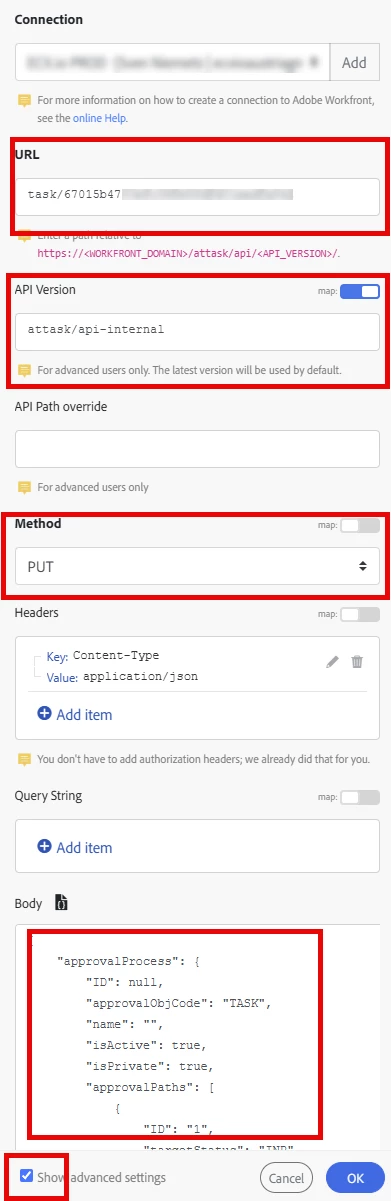

Best answer by Sven-iX
I understand.
The createRecord module is plain unable to create a single-use / private approval process. Many fields missing. Like, where are you setting up stages, and approvers? So this module ONLY creates non-private, system-level approval processes.
The only way I know to create single-use approvals is using the customAPI module:
  • you have to use the internal API
  • use PUT as method
  • you have to supply a JSON object that has
    • approvalProcess
      • approvalPaths[]
        • approvalSteps[]
          • stepApprovers[]
When you trace the actual call made in the UI you'll notice that the UI helps itself by creating dummy IDs because in the JSON you have to relate the nested objects to each other, e.g. relate the setApprover to the approvalStep. In your JSON you can just use 1, 2, 3 etc.
Example JSON attached. I pasted this into the body field.
Note that you pass the ID of the item on which you want to approval in the "URL" line
Sven-iX

Sven-iX
Sven-iXCommunity AdvisorAccepted solution
June 18, 2025
I understand.
  • use PUT as method
    • approvalProcess
      • approvalPaths[]
        • approvalSteps[]
          • stepApprovers[]
