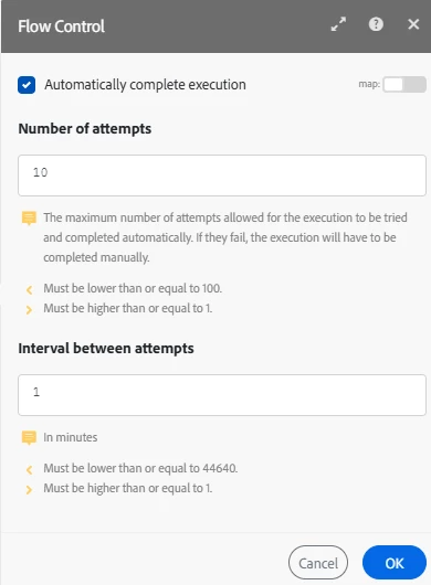

Best answer by Lawson02
I have the same scenario with an excel module. I use a break module with incomplete executions setting set to on. This works for me.

Thanks for this idea @lawson02 ,
I will have to learn about error handling.
In the meantime I could find an interesting setting in the scenario settings that stores the incomplete executions in a separate table and they can be completed later. I made a test and I was able to complete a task that failed.

Sven-iX
May 9, 2025
@sebastiendesautel
By turning on "store incomplete executions" you make it possible for @lawson02's approach to work. Fusion will automatically retry N times with Y minutes between tries. For transient errors such as you list, this is the correct approach. I always try to avoid incomplete executions - and I've had cases where the execution can't be salvaged (e.g. due to unexpected incoming data) and have it turned on only for the BREAK module usage.
If a simple BREAK module doesn't work (or you want to avoid marking the execution as "incomplete") you can roll your own retry and then park the original request bundle in a data store for later retry (since your scenario starts with a webhook).
I've used a flavor where I create my own "retry" logic so that I can, on the last failed retry, create a notification or take another action. The approach involves a repeater and branching success/error paths. Not necessary unless you want to be able to have a "finally" option to your error handling.
