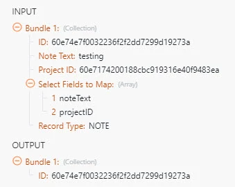

  2. I am still not seeing the Notes being copied over to the resolve project. I am using a update 'note' card with the note text as the issue's "note text" and the project ID as "resolve project ID". I anticipate I will run in to the same problem here too where ALL the notes come over and not just the last note. The module runs w/o error, but the output never makes it to the project. 0694X00000EM8kGQAT.jpg
