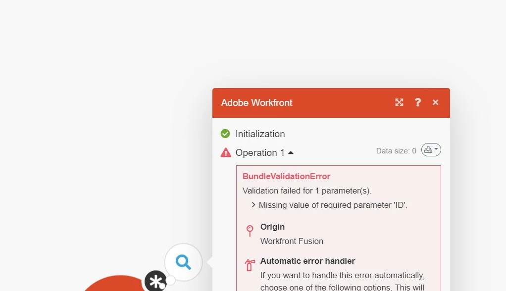

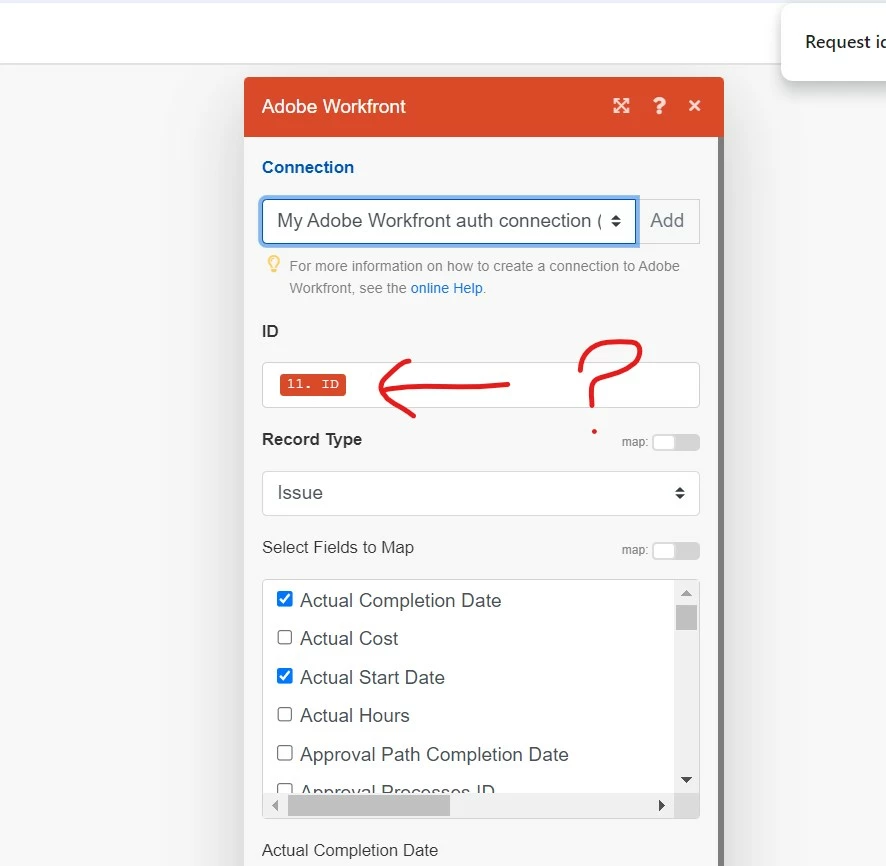

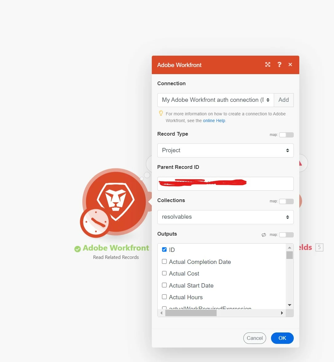

Hello, I would like to pull in all requests from a specific campaign. I have used the read related records module, and inputted my parent ID, what do I need to choose in collections to pull in all requests?
When I do it as shown in the screenshot, I am getting the error "Missing value of required parameter 'ID'."

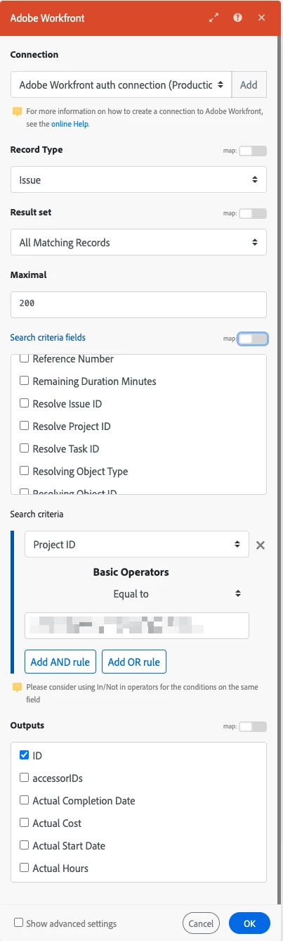

Hello MeghanaKa1,
although there should also be a way using the Read Related Records module, I was not successful using that.
So I would switch to the Search Module and configure it like this:
1.) Record Type: Issue
2.) Search criteria: Project ID
This will provide you will all issues / requests within a specific project.
