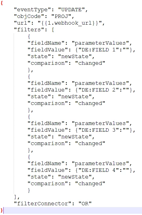

I recently learned (thanks JustinG and @chrisstephens) that you can create a custom event subscription:
The watch event module gives only a simplified version - most annoying that it doesn't allow OR filters.
Check out here Event Subscription API
You can use Fusion to a) remove existing subscriptions that point the your event module, then b) add the needed subscription and filters. In your case something along the below might work.
