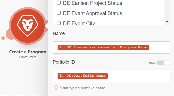

Under the Create a Record - Program module, I mapped the field of Portfolio ID with the typehead field of Portfolio entered by the requestor when they submit the request:

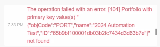

However, we received an error saying The operation failed with an error. [404] Portfolio with primary key value(s) "{"objCode":"PORT","name":"2024 Automation Test","ID":"65b9bf100001db03b2fc7434d3d63b7e"}" not found
I am pretty sure that the way we mapped the Portfolio ID with the Portfolio Typehead field is causing this problem. May I know what would be the right way to map the fields or to resolve this issue? I also tried using read a record module on our first Watch Record - Issues module. I chose to read portfolio record and the ID I put was the issue id from the watch record module. But there's also another error preventing me to read the record. My guess is that is not really considered as a record since the issue is not tied to a portfolio.

You need to pass the string from the Typeahead field thru a parse JSON module, and then you can map the ID directly.
