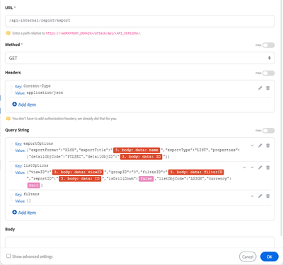

My query:
and I get an error:
The operation failed with an error. [422] Invalid Parameter: listOptions value "{"viewID":"6047a6ce003f42586dc19dea1904a608","groupID":"0","filterID":"6047a6ce003f425ccdd376d63f4fc548","reportID":"6047a6ce003f425e8ec64e347a564d9f","isDrillDown":false,"listObjCode":"ASSGN","currency":},JSON parsing error at line 1, column 206"
I tried to replicate the request by using the value from Workfront report export operation, but now I get
RuntimeError
[422] null objCode
I tried adding objCode:PTLSEC, but get the same error.
What am I missing?
