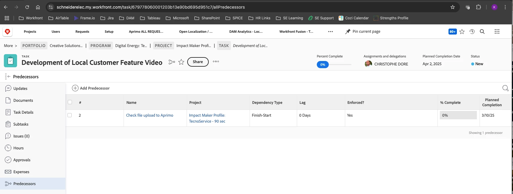

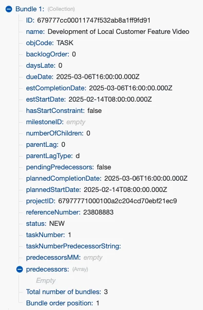

Has anyone been able to read cross project predecessor information in Fusion?  We are trying to read the predecessor projected completion date to then reset the planned start date on the second project to have accurate capacity planning.
Project A - Task 3 need to be completed  for Project B Task 1 to start.
I'm not seeing where I can pull predecessor from a different project.  Only the predecessor information from that same project.

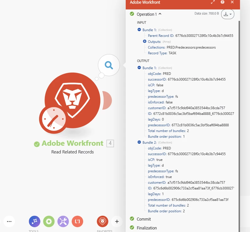

Not sure what your module is that you are using in the  screenshot above but what I have done in the past is to use the "read related records" to get the predecessor collection details of a task. Then you can use a read record to get the task details of the predecessorID
