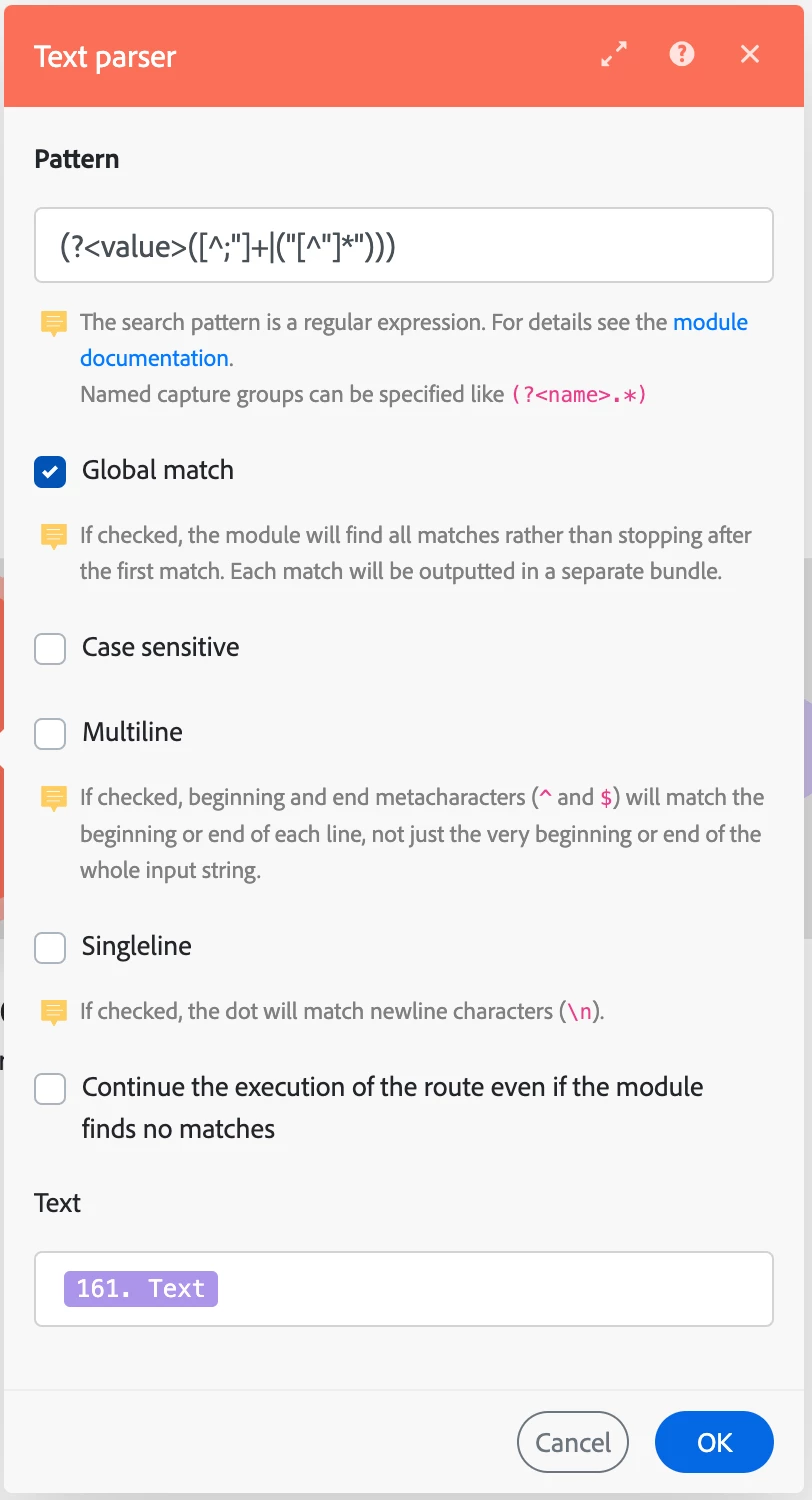

Hello Nick,
Sorry, I think I accidentally posted the wrong expression...
This is my setup of the module:
I'll keep my fingers crossed that it works for you.

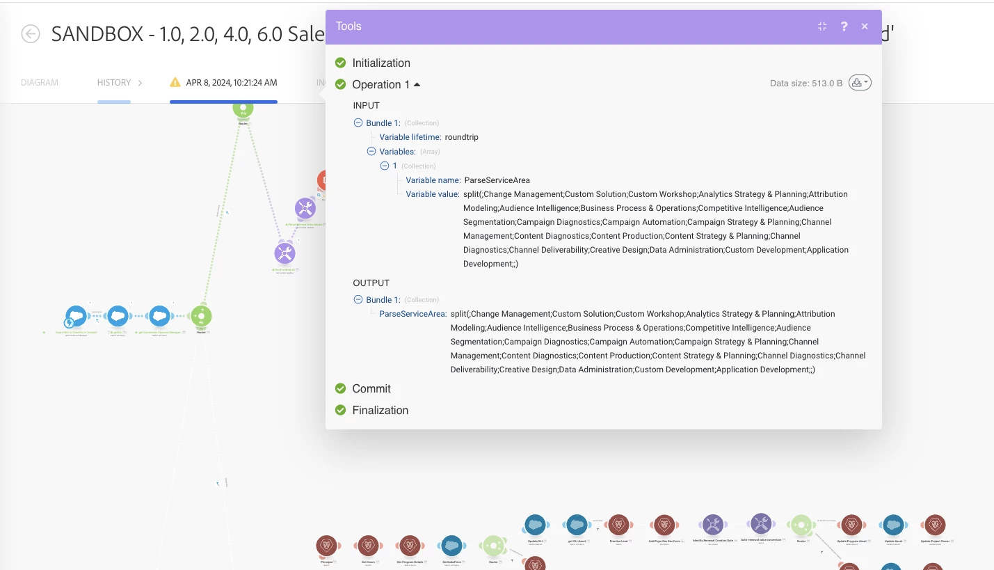

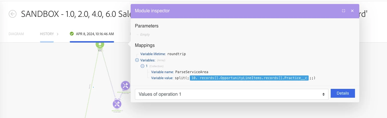

If you pass the string thru a split(;{your field};;), then it should give you an array, then you should be able to map it directly. Note, put the semicolon you want to use for the split in before anything else, or fusion will think it's part of the code and it won't work. (There shouldn't be the grey box around it)

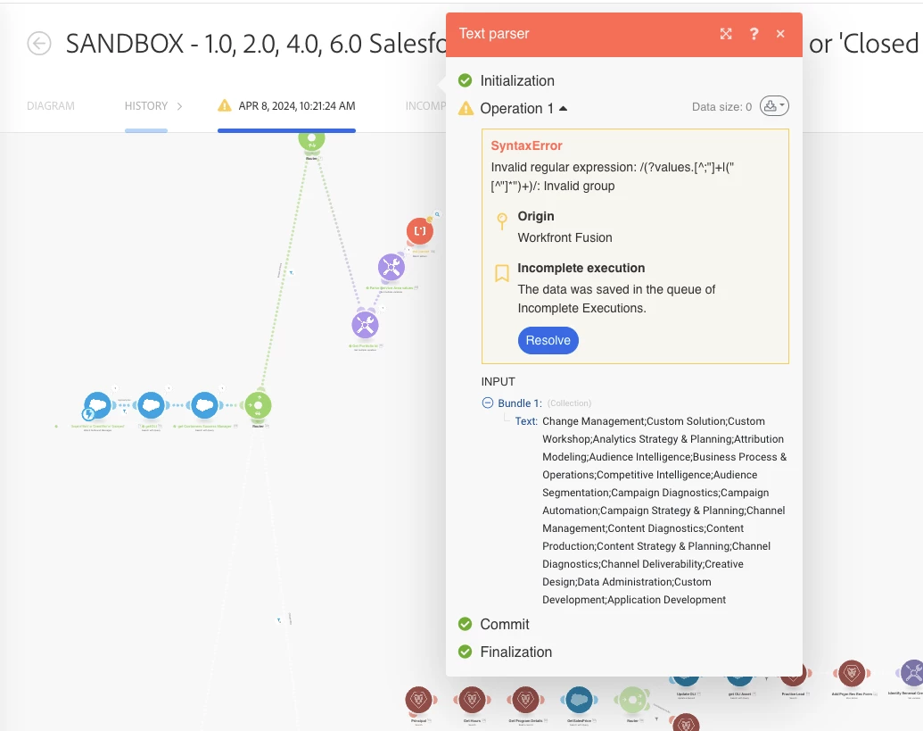

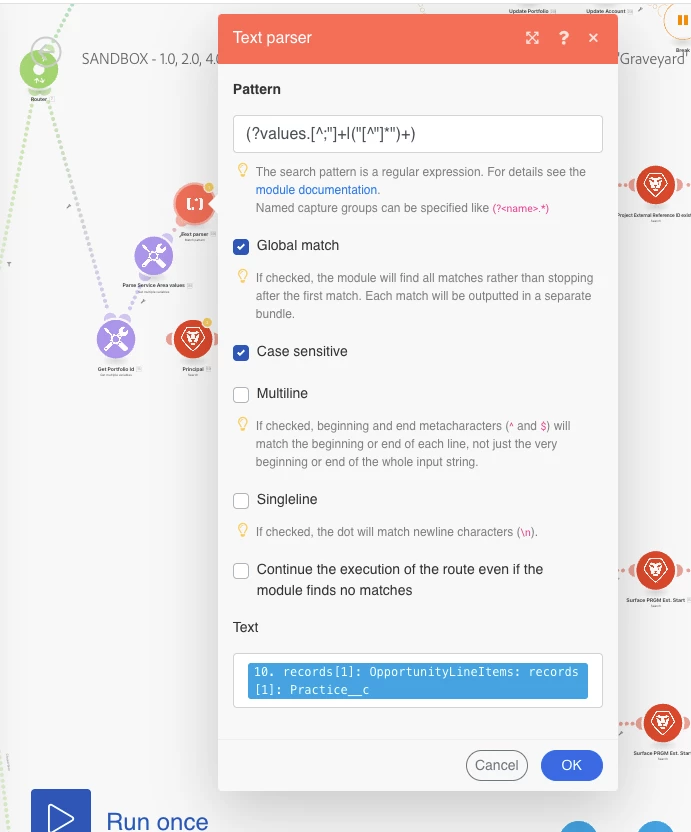

Thanks, Chris and Lars.
I've tried both without success so far.
Lars, this is what I got when using Text Parse Match Pattern:
This is how I set it up:
Chris, here's what I'm getting when I try your method:
Might I have misinterpreted some of the direction?
