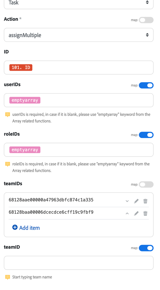

Ah, I finally got it to work. I'm posting a pic here to help any future people with this issue.  There may have been a couple things that finally helped. 1. at some point I added null to the bottom teamid in case it also needed data, but I ended up taking it back out for this version.
2. I think the main issue was that for the teamIDs, I had been trying to pass the individual ids. Finally I turned the ids into an array, which I first tried mapping and pointing to, which it also didn't like (see below/above).  So I turned the mapping off but pointed to the objects in the array and that finally worked.

Hi, it turns out that it wasn't as complicated as I thought, but if any of the parameters were wrong, it caused an error. This simplified version shows everything in place.

You can't pass the array, you have to add each value as a separate item.
