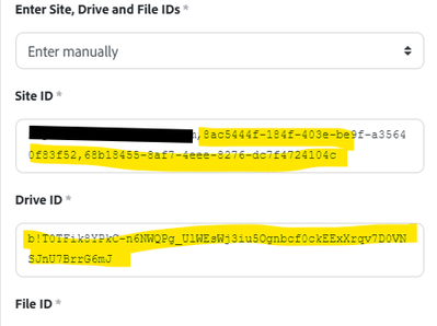

I am currently trying to use the SharePoint Online module "Get a Folder" with "Enter Manually" selected in the Enter Site, Drive and File IDs field. However, I am unable to format the "Folder Path" field correctly. I have tried multiple ways of retrieving the path of a folder in SharePoint with no success. Are there examples of anyone using this module successfully or documentation I could be pointed to?

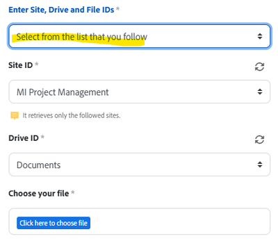

find the file using the Select from the list you follow option to find a file in the same folder you are looking to pull into your scenario...
Once you locate the file set it back to manual and the file path will be displayed. From there you can determine the path
