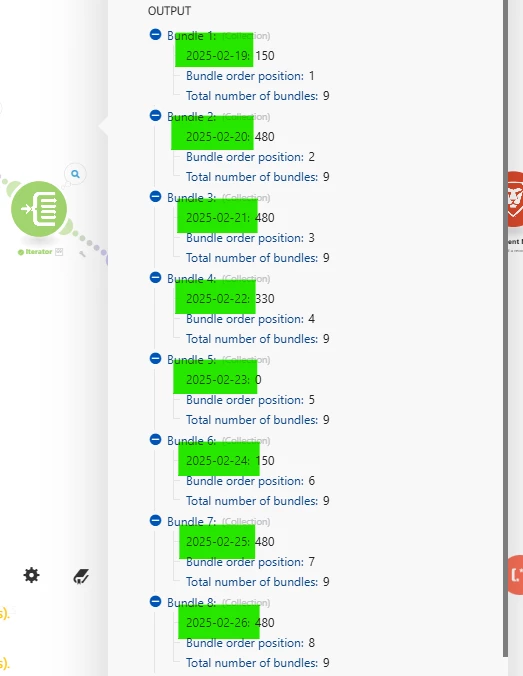

How to get below highlighted date from the iterator bundle output?
Hi @Sethu_AnandR
here is one way -
but I'd suggest not using a value you need as a key... So I would modify the scenario upstream so you end up with eg
  • Bundle X
    • date: 2025-02....
    • value: 480
