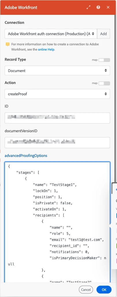

I am working on a process flow to create a proof based on the document on a task but I want to also modify the details of the Proof which can only be done via the advancedProofingOptions at the bottom of the Misc Actions modules. I found that a Json string must be passed on to this field but I have been trying the example given in Experience League and it does not work. Is there a documentation on how each field should be mapped on to the Json string? such as Name, Email, etc..

On my instance it is working using the Misc Action Module with the action createProof and a JSON in the following format in the field advancedProofingOptions:
{ "stages": [ { "name": "TestStage1", "lockOn": 1, "position": 1, "isPrivate": false, "activateOn": 1, "recipients": [ { "name": "", "role": 5, "email": "test1@test.com", "recipient_id": "", "notifications": 0, "isPrimaryDecisionMaker": null }, { "name": "TestStage2", "role": 5, "email": "test2@test.com", "recipient_id": "", "notifications": 0, "isPrimaryDecisionMaker": false } ], "isMandatory": false, "deadlineDate": null, "deadlineTime": null, "isOneApproval": true, "activateOnDate": null, "parentPosition": null, "activateOnDecision": null, "deadlineCalculateOn": null, "deadlineBusinessDays": null } ], "message": "This is a Test", "subject": "Test using Fusion", "templates": [], "hasMessage": true, "canDownload": true, "customfields": [], "hasPublicSharing": true, "isAutomatedWorkflow": true, "stageBasedVisibility": 0 }

Hmm. I need to investigate this further some time, but as described in the last note box in the linked Experience League document, Adobe wants us to play around with the proof module to find out how to setup the parameters...

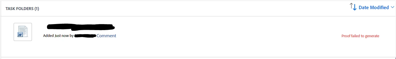

This is what I get after trying a very similar Json text to yours
And this is the json that I used just replacing the email for the people I want for reviewers on my proof.
{ "stages": [ { "name": "TestStage1", "lockOn": 1, "position": 1, "isPrivate": false, "activateOn": 1, "recipients": [ { "name": "", "role": 5, "email": "user@mydomain.com", "recipient_id": "", "notifications": 0, "isPrimaryDecisionMaker": null }, { "name": "Workfront User Name", "role": 5, "email": "usern2@mydomain.com", "recipient_id": "", "notifications": 0, "isPrimaryDecisionMaker": false } ], "isMandatory": false, "deadlineDate": null, "deadlineTime": null, "isOneApproval": true, "activateOnDate": null, "parentPosition": null, "activateOnDecision": null, "deadlineCalculateOn": null, "deadlineBusinessDays": null } ], "message": "This is a Test", "subject": "Test using Fusion", "templates": [], "hasMessage": true, "canDownload": true, "customfields": [], "hasPublicSharing": true, "isAutomatedWorkflow": true, "stageBasedVisibility": 0 }
