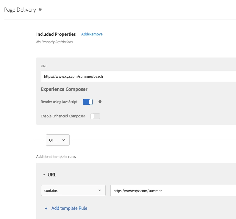

I have created an experience targeting with a pop-up display on pages. in this experience targeting I added a template rule to show the same experience on multiple pages. However, don't know why I am skeptical. I started creating experience targeting with the following page <https://www.xyz.com/summer/beach> and want this experience to be displayed on all pages that contain the following URL <https://www.xyz.com/summer>
Does that make sense?
However, my only concern is that on the pop up the CTA button has a URL directed to a page that also contains <https://www.xyz.com/summer> so when I click on the CTA button of pop up the page I am landing on also shows me a pop-up again. How can I avoid that?

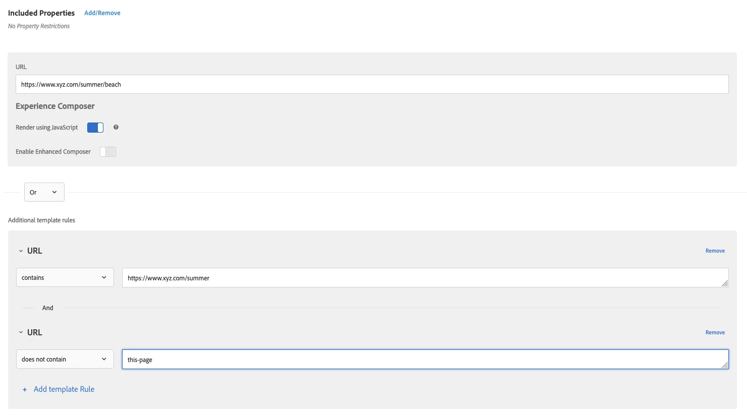

@JyotiSharmaV - You could just add another rule that states "does not contain" and add the parameters of the URL that come after "https://www.xyz.com/summer".
For example, if the page is "https://www.xyz.com/summer/this-page" the rule would be as follows:
I hope that helps!
I hope that helps!
Matt Ravlich | ACG Digital
@Matthew_Ravlich_ACG Yes, that worked perfectly for me. But pls let me know when I was passing. the complete URL instead of the parameter why that was not functioning
@JyotiSharmaV - Target URL targeting looks for an exact URL match. If the URL matches, Target does not consider further logic. See more details here: https://experienceleague.adobe.com/en/docs/target/using/audiences/faq-audiences/troubleshooting-targ...
