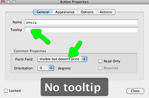

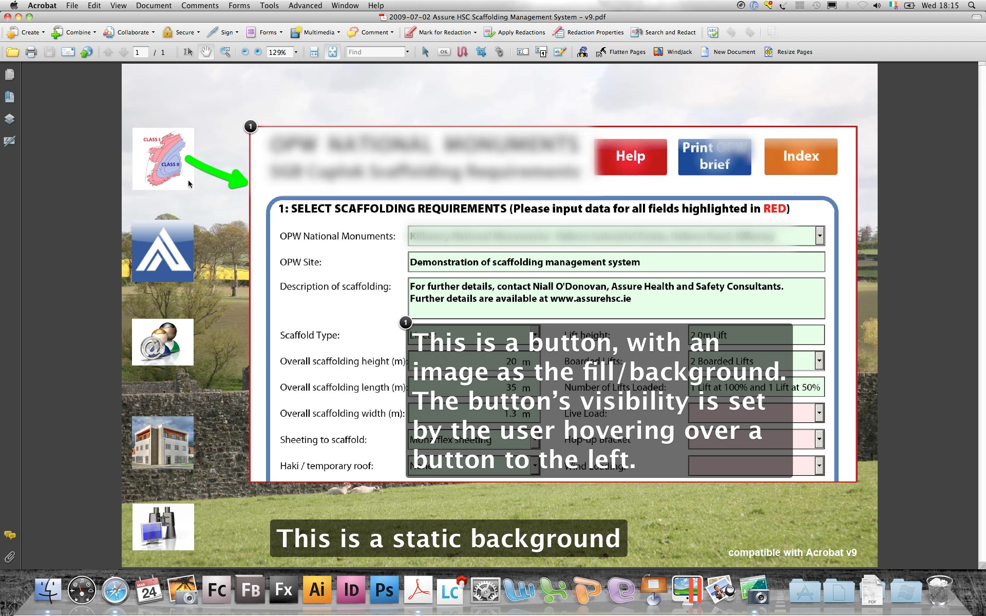

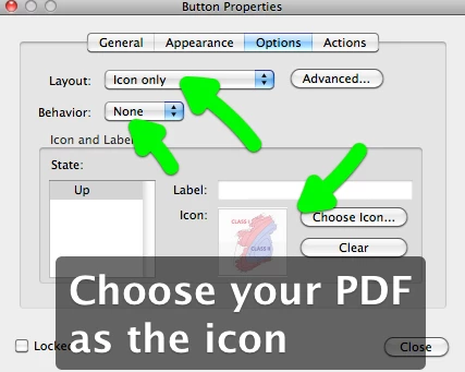

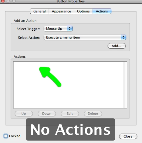

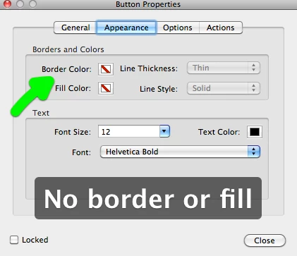

The last thing I can suggest (and I believe you can do this in Acrobat 8) is to start off with the blank PDF and from the Forms menu add a button to the page.
Resize the button to the full page and then right click on the button and get its properties.
The screen shots should look similar to v8. I am just going to highlight some of the setting you should set for the background button.
In particular make sure that the button behaviour is set to NONE in the Options tab.

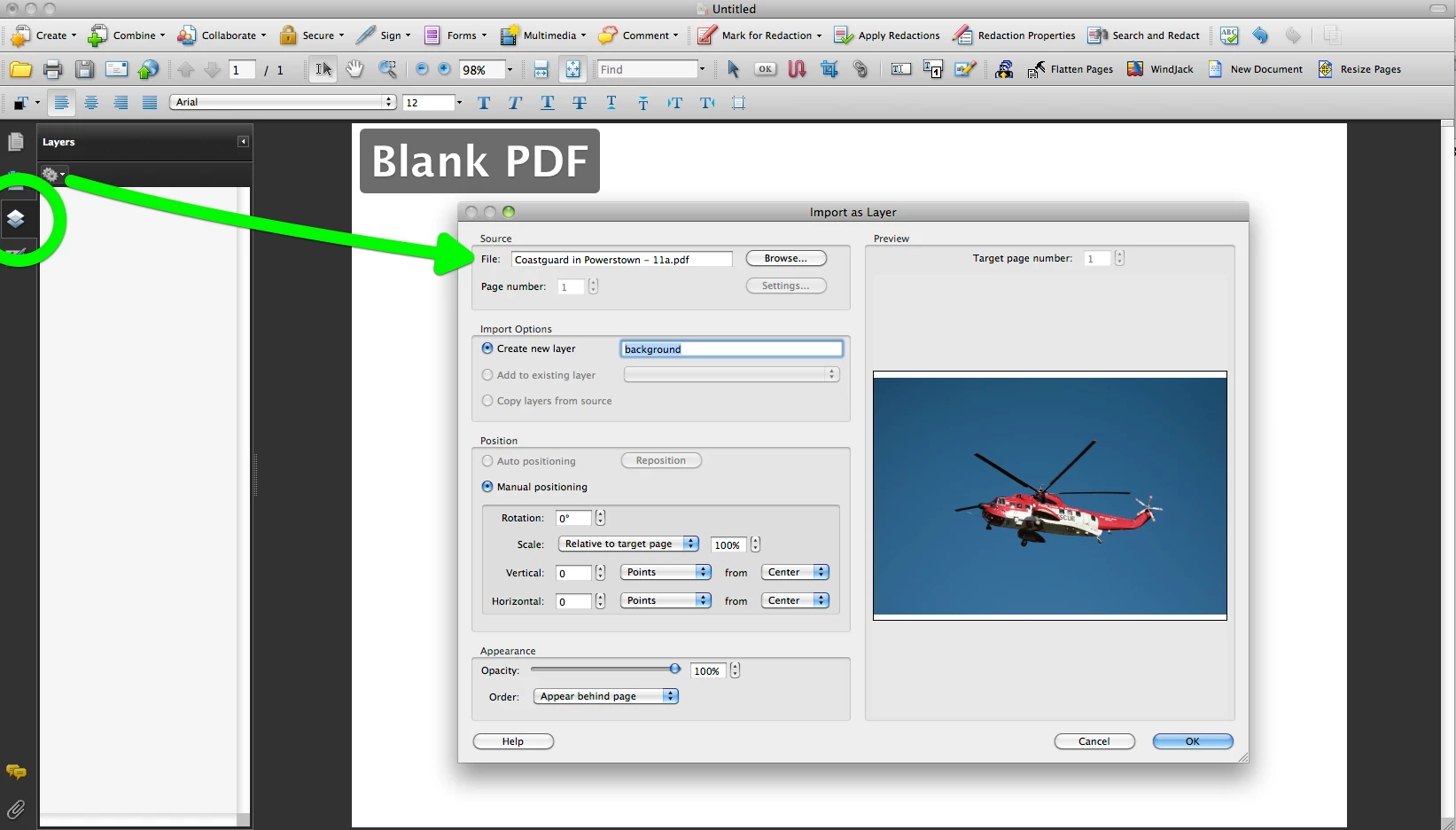

What I did was open Acrobat and create a blank PDF (setting the page size and orientation to what I want - in my case A4 and Landscape). In Acrobat 9 I can do this from the File menu. There are examples of javascript for adding new pages (windjack.com have a free sample).
Then in the View menu select Navigation Panels > Layers. Open the layers panel and from the top menu select Import as Layer.
Now you can browse to your original PDF and give the layer a name eg "background":
Once you have the layer in the blank PDF you can set the printing to none in the layer properties. It should look just like your original PDF, but the content is now in a layer that you can control.
Let me know how you get on,
Niall
PS another important setting is to have the layer behind the page, so that the new form objects will appear over the image. Also if you have multiple pages, you can import single page PDF and target each page in turn.

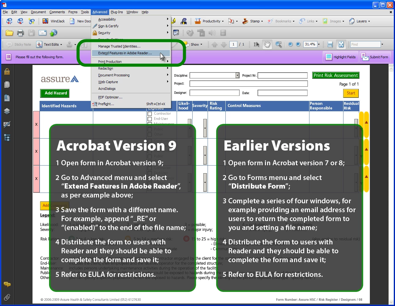

Here is a summary of deployment options when sending out a form to users with either Acrobat or Reader.
http://cookbooks.adobe.com/post_Using_LiveCycle_Forms_in_Acrobat_and_Reader-16518.html (it is at the end of that post).
The issue for users with Reader is whether the form is Reader Enabled or not. If it is not Reader Enabled then the users will not be able to save the data. If however it is Reader Enabled then they will be able to save data.
The next issue is how to apply the Reader rights to a form. This can be done one of two ways:
(1) Apply the rights through Acrobat (v8 Pro in your case). There are license restrictions - read EULA
or
(2) Apply the rights through LC Reader Extensions ES2, which is a server product and also costs per form enabled.
Here is a graphic:
You would be looking for "Distribute Form" from the Forms menu.
Good luck,
Niall

First off, you cannot apply Reader rights (enabling) in LC Designer - at all. LC Designer is just for developing the form, which will ultimately be opened by the user in Acrobat/Reader.
You can purchase an additional LiveCycle component called LC Reader Extensions ES2. This is a server component and is intended to make it more efficient to handle data from thousands of forms by automating the data handling. The purchase of LC Reader Extensions ES2 is a cost, but also there is a cost associated with each form that is Reader Enabled through LC Reader Extensions ES2. You would need to talk to an Adobe sales rep in your geographical location.
The only other way to apply the Reader rights is through Acrobat. From the deployment summary you will see that while some Reader features are turned on, others are turned off.
Right - in Acrobat v9 Standard, you can apply the Reader rights from the Advanced menu. This is a one step process that applies the rights without distributing the form.
In earlier versions of Acrobat (v8 and below) the ability to apply Reader rights was in the Professional version only.
Now this is not a problem to you because you have Acrobat v8 Professional. However in v8 the process of applying the Reader rights is tied into the distribute function. So you will need to provide an email address. While you do NOT have to have a submit by email button on the form itself; Acrobat will place a Submit Form button on the red Forms ribbon at the top (see screenshot in previous post).
Now, don't shoot the messenger - one option would be to upgrade from Acrobat v8 Pro to at least Acrobat v9 Standard (you can go Pro or Pro Extended is you want). This will give you the ability to apply Reader rights, without distributing the form.
Bear in mind that you will still be tied to the same restriction in sending out the Reader Enabled form to 500 persons or data processes. See EULA.
