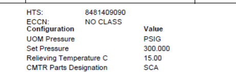

So here is the Problem I have an example where page breaks happen correcly until the line_item subform is placed again at the top of the row of the line items table. Then all Information is flowing over the border of the Body page and even over the border of the page. The main Information should not page break within Content, but the following subforms.
See here the symptom:
Then I thought ok if the Problem is the line_item subform is the Problem, I allow it to flow over to the next page. The the symptom is that the margin of the next subform is not respected (ECCN is part of line_item and Configuration is part of next subform):
All subforms flow correctly as Long as the line item subform is not the first to Show after a pagebreak happened.

Did you allow page breaks for all the parents of "Line_Item" too (which are "itemtablesubform", "Row1", "Itemtable", "ITEM" and "Body_Page")?
