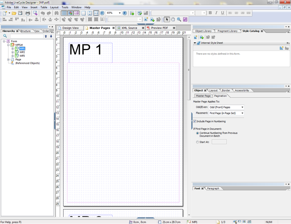

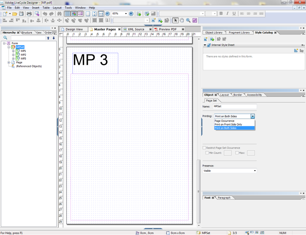

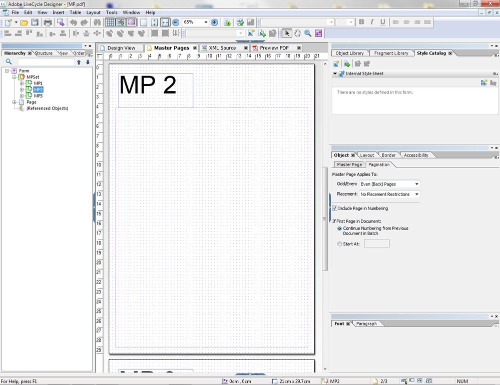

master pages belong to a page set, which has a printing setting.
Default is "Page Occurence". Change it to "Print on Both Sides".
Then you can set the Pagination for each master page in the page set individually.
Master Page 1: Odd Pages and only the first Page
Master Page 2: All even pages
