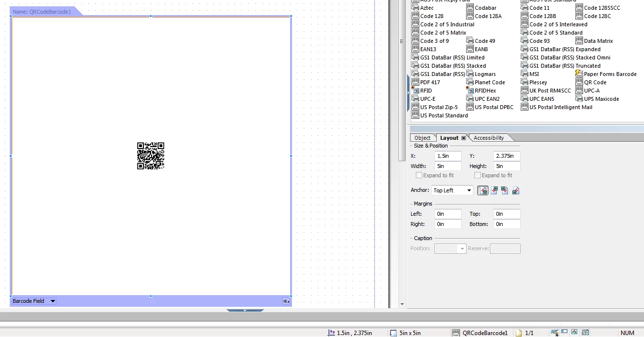

I found that option on Layout tab. But it changes only size of background of QR code but not QR code itself. I put 40 characters in it (it will be approximately like this). Under Width and Height is option Expand to fit(for both), but they are both greyed.
Could you explain it little more how to enlarge QR code(maybe some printscreens)?
Thanks a lot.

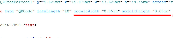

In XML Source tab ,Modify the value of the "moduleWidth" and "moduleHeight" fields.
