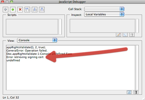

If you open the form in Acrobat (not Reader or any third party viewer), then you can test to see if the form is Reader Enabled.
  1. Open the form in Acrobat.
  2. Open the JavaScript Console (Control+J).
  3. Paste this into the console and hit Control+Enter to run it: appRightsValidate({}, 2, true);
  4. If it returns the signature properties, then the form is Reader Enabled.
  5. Otherwise, if it returns an error, the form is not Reader Enabled.
Your form does not appear to be available on Ge.TT, so I can't test. I suspect that your form IS Reader Enabled, but that the use of viewers other than Acrobat or Adobe Reader is adversely affecting the data.
Form is Reader Enabled:
Form is NOT Reader Enabled:
You can get details about testing a form here: http://learn.adobe.com/wiki/download/attachments/64389123/LiveCycleReaderEnabledDocs.pdf?version=1&modificationDate=1285636868000.

Hi Johnny,
Hope that helps,
Niall
