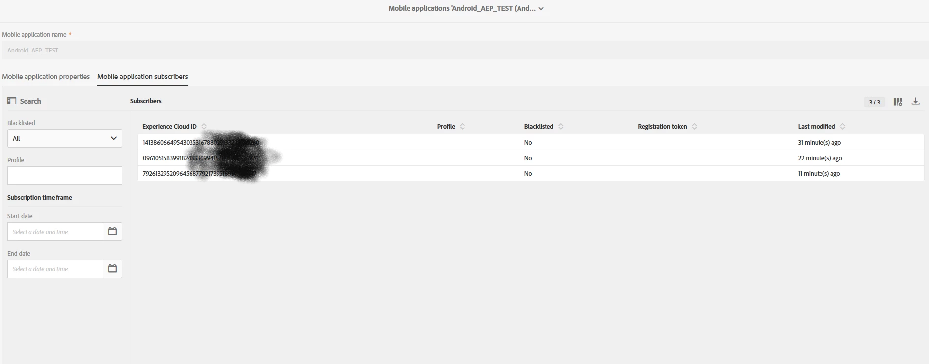

hi, having some issues with sending push notifications from Adobe Campaign Standard to android app subscribers, I can see that when running the app the generated ECID will be posted to our campaign instance and populate the subscriber table, but the token is missing, i would expect to see the FCM token here.
as the push notifications are not delivered when testing, is it because the token is empty?

As a sidenote, updating this field manually in the related record with an update data activity (containing the FCM token string value) is possible to do, but the value wont show in the subscribers overview (see picture).
