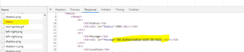

I have migrated workflows from 6.1 to 6.5 but I have an error and flow does not end. I do not have information on logs, but on browser, I can see a 500 server code when try to acces /bin/workflow/inbox and I see this text:
 <title>No Authorizable with ID null</title>

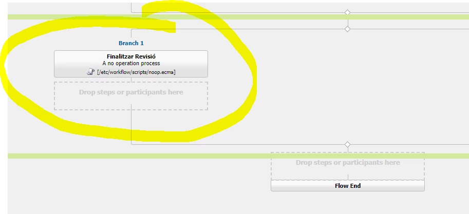

Last step  does not execute logic:
