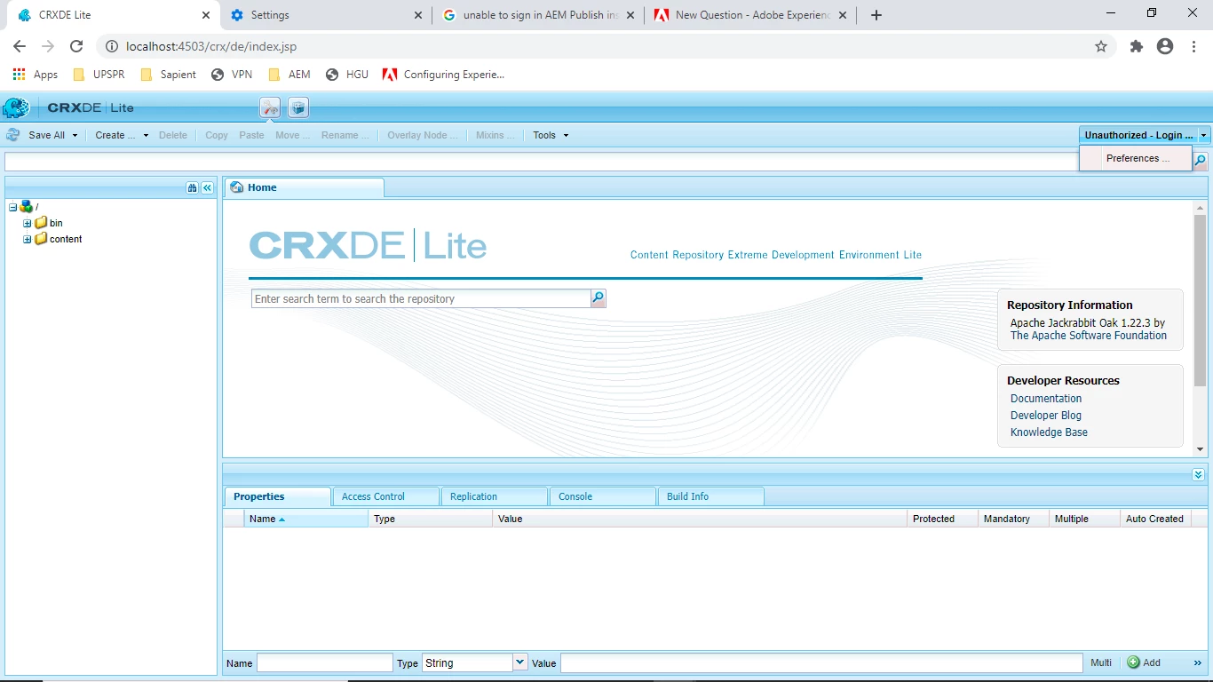

I am not able to Sign in to AEM 6.5 Publish Instance. I cleared up the cache and cookies and still not able to login.
I have signed in from the machine and with the same set up earlier as well. When I click on the login button I only get to see the 'Preference'.
Please suggest what could be the issue here.
@zameer_abbas do you have this issue an a vanilla AEM 6.5 instance? I have the  similar one after Service Pack 6  installation. I haven't found the root cause yet. Meanwhile, you should be able to use /libs/granite/core/content/login.html as a workaround at the moment I guess.

Hi Santosh, I am able to access http://localhost:4503/content/we-retail/us/en.html but I can't see any changes I am publishing from the author environment. When I tried to sign in into the CRX, I couldn't.

I am using AEM Service Pack 6.5.5.0
CRXDE login is restricted onwards 6.5.5.0. You need to use /libs/granite/core/content/login.html
@Dan_stemakh Yes it is an vanilla AEM 6.5 instance. This work around worked for me. Thank you so much. However, I still don't understand what exactly is the issue here. Regards.
No root cause? Authentication in via CRX DE was removed from the product and documented in the release notes.
